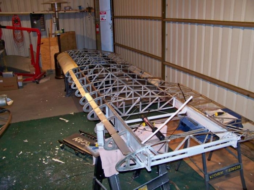

Date:  2-4-2012
Number of Hours:  4.00
Brief Description:  Wing Clean-up and Repair
I did another session of cleaning up wing parts, improving on existing rib repairs, and removing more parts for clean-up and paint. I re-installed some of my first load of wing parts. I also cleaned and painted the area of the spars that I was working in. I also started removing some of the leading edge skins as I needed access to the ares they were covering. The parts I pulled off today I took down to my old business and blasted, primed, and painted the parts. They should all be cured nicely by tomorrow afternoon and ready for re-installation. When items are re-assembled, I'll have pictures then.
Starting repair/clea-up work on the right wing.
