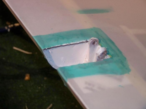

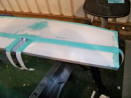

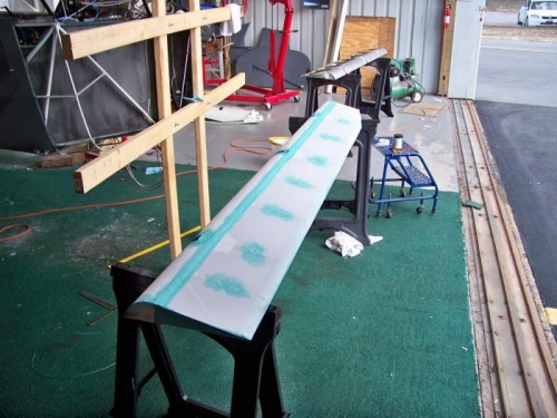

I cut, then installed the dollar patches for the rib stitching covering. I also rolled the edges on my two new elevator inspection plates, and have them ready to drill the mounting holes. Back to the right aileron, I installed all but one of the tapes. All the hinge wells are finished off, along with the tapes that cover some of the rivet heads. I have the trailing edge tape and end tapes to go, and I'll be finished.
One of the hinge wells trimmed up and ready for  taping.
Reinforcement tapes being glued into place.
Right aileron all but finished.
