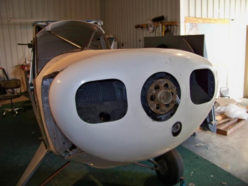

Old nose bowl mounted into place.

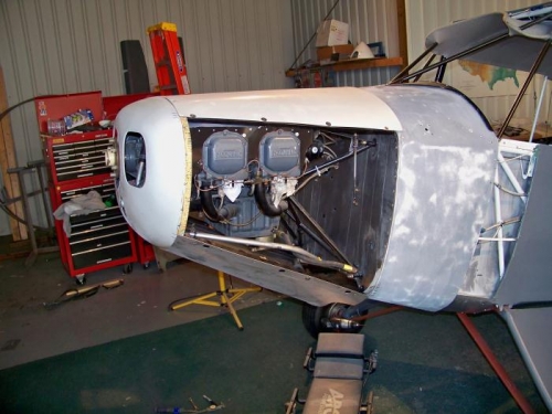

The top and bottom pieces mounted helps to square everything up.

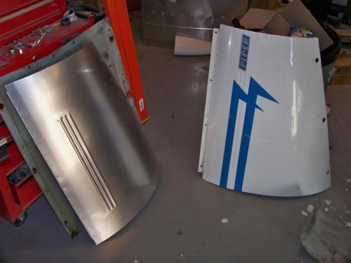

New vs. old side cowling piece.
