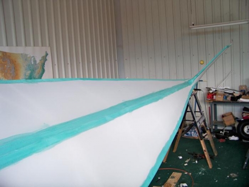

Installed the last of the fuselage reinforcing tapes, checked all my work, then started the clean up prior to starting with the EkoFil. I decided to start filling the fabric with the bottom side, so I checked all that surface for anything that need removal/cleaning, Wiped the surface down with cleaner, and got started with the filling. I did the first half of the cross coat and let will let it dry before coming back and doing the other half.
All the tapes installed on the top of the fuse

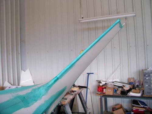

Center tape going through the vertical stab transition area

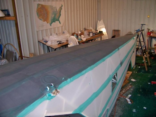

First half of first cross coat on fuse bottom
