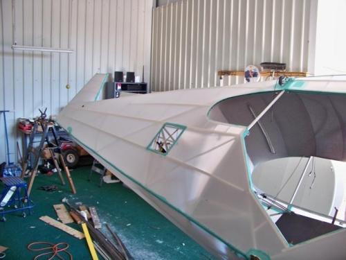

I checked all the results of the first shrinking of all the fuselage fabric, and then applied all the necessary reinforcement patches where needed. I then did the 300 degree shrinks of all the fuselage fabric. I still need to do the 350 degree shrinks and then it's time for the tape application.
Fuselage with first & second shrink

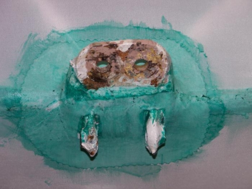

Rear gear leg attach point patch

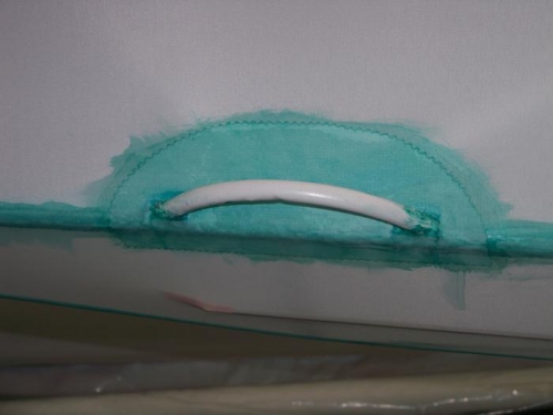

Fuselage handle patch
