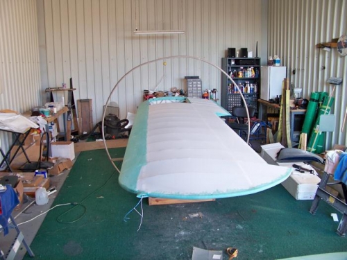

Brief Description:  Right Wing Clean-Up& Left Wing Start
I cleaned and sanded the right wing today, getting all the little glue specks & other contaminates off the fabric. A couple of small spots needed additional heating with the small iron to get edges to sit down completely, so I took care of that. Next, I started measuring and marking the stitch points on the left wing. I punched the stitch positions on the inboard end of the left wing and got the first two inboard ribs stiched up.
Time to start stitching the left wing.
