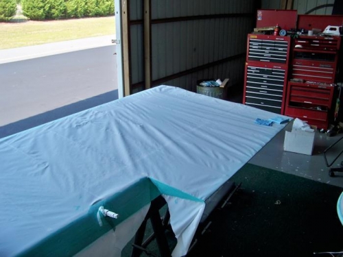

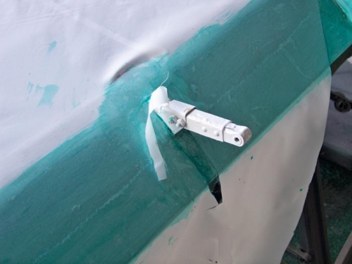

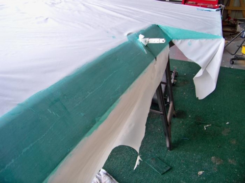

I came back in this morning and glued down the trailing edge of the wing fabric. I started with the inboard trailing edge, and got it all glued and ironed down. I then moved into the aileron bay/ false spar area and got all of that glued into place and ironed down. I'll come back next time and trim the trailing edges, iron the edges down, and then close out each end of the bottom fabric and get it ready for its first shrink.
Trailing edge for the inboard end glued down.
The aileron bay with its fabric glued down and ready for trimming.
A bit closer shot of the fabric around an aileron mount. Just a little trimming to go.
