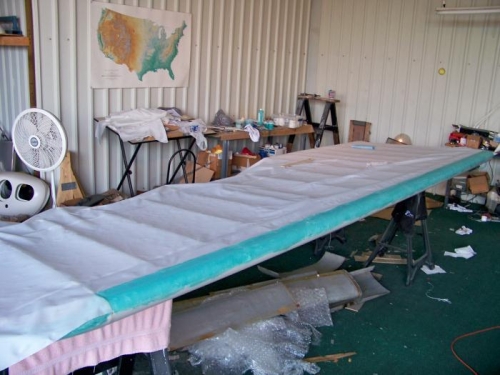

With the wings flipped over, I went around both wings and cleaned up areas of glue residue and ironed down any loose edge pieces. With the wing clened and prepped, I cut the fabric for the bottom piece. I laid out the leading edge of the fabric and glued the leading edge down. The glue will now dry before next session, allowing me to pull lightly on the fabric without worrying about it moving.
Leading edge of the left wing glued down.
