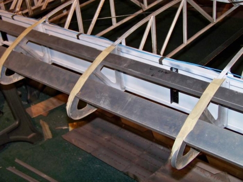

Brief Description:  Install Leading Edge Supports
I installed and taped down the supports that are fitted under the skins themselves to provide rigidity for the skins themselves. My new skins should be here by Monday, so I'm stuck doing minor projects until then. I measured and cut the wood pieces that mount in the fuel tank bay to serve as a gluing surface for the fabric when it terminates in that area. They have their first coat of varnish on, and will get their final coat next work session. Lastly, I took apart my wingtip nav light assemblies so I can bead blast those and get them painted and ready to re-install.
Leading edge stiffeners in place,
