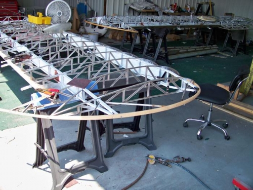

Brief Description:  Right Wing Tip Bow Work
I started working on the installation of the wing tip bow for the right wing. I mounted the attachment brackets and got them all lined up. Then, I Installed the bow itself. Working with one mount point at a time, I worked my way from one end of the bow to the other, and had to make a few extra braces along the way. Now, both wing tips are braced the way Super Cub tips are. Should make them much less likely to warp. The new braces are primed, and the bow itself was given two coats of varnish for protection. Also, I fabricated the leading edge braces needed for the right wing. One whole set of braces was missing from the right wing, so now it will be equipped with the braces the way the factory designed it to be.
Right wing tip bow assembly fitted and ready for varnish.
