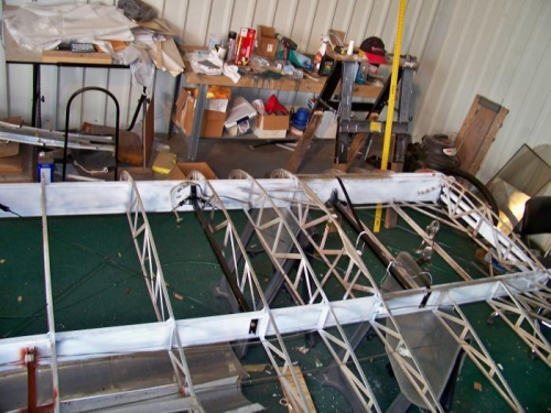

Brief Description:  Left Wing Clean-up Finishing Touches
All of the compression struts and drad/anti-drag wires in the left wing are now cleaned, re-painted, and installed back to their rightful positions. All of the wires have been trammelled and the wing is now straight and square again. I also installed the aileron mount reinforcing brackets on the left wing, so now that wing only needs turning over and cleaning the bottom surfaces before being ready to install the new leading edges. Next up is the installation of the wing tip bow on the right wing and it will be ready to flip over as well.
The left wing, all back together.

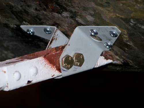

One of the aileron bracket reinforcement plates installed.

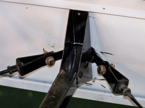

Compression strut and wire attach brackets back in place. Scratches on the spar web will be re-painted
