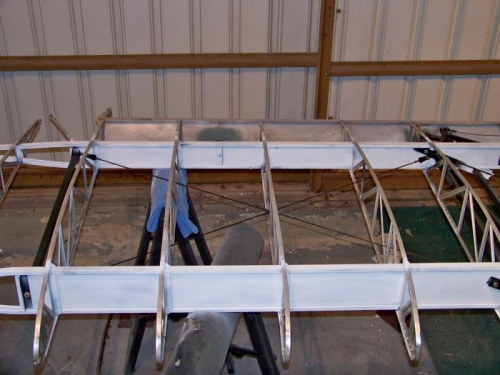

Number of Hours:  2.20
Brief Description:  Drag/Anti-Drag Wire Work
I finished the installation of the drag and anti-drag wires on the right wing. All but one of the wire bays are trammeled back to square. Next on the clean-up list is to remove the aileron mount arms, clean them up, and put them back with the newer support brackets that kill off an inspection AD for that area.
Last compression strut bay cleaned up and re-installed.
