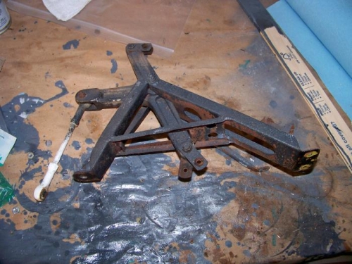

Worked on dis-assembly of the compression strut area where the wing struts attach to the wing. This assembly is pretty complex and needed a lot of attention and time to get it apart properly and still remember how to get it back together. I re-assembled the comprssion strut just inboard of the previously mentioned strut. After I get the monster strut back together, I'll only have the outbord compression strut left on the right wing. Took the parts I pulled off today and bead blasted them at my old shop. They are now clean and ready for priming and paint.
Aileron bellcrank assembly before clean-up.
