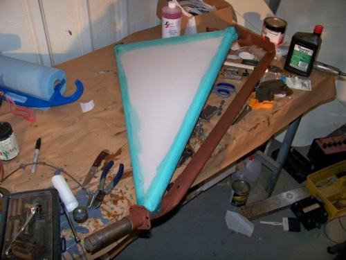

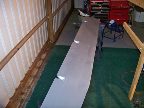

Started the first crosscoat of EkoFill on the right aileron and cabin door. Got the crosscoat applied to one side of the aileron. I'll let it cure overnight and get the other side tomorrow. Also, I got the rest of the fabric on the right landing gear assembly. Both sides are now on fully glued in with one shrink done. I'll come back tomorrow and get the tapes installed.
Starting the brushed crosscoat on the aileron.
Covering on right gear leg installed.
