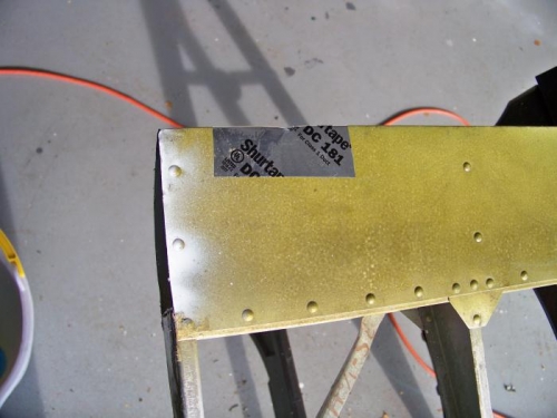

Brief Description:  Aileron Clean-up and Priming
Finished the last of the stripping clean-up for both ailerons. I also replaced all of the #4 sheet metal screws in the two units. With all of that done, I primed the areas around the screws, plus primed and painted the hinge mount well areas. Painting this now will take care of having to put paint in this confined area without over-painting the surrounding fabric.
Leading edge area primed. Aluminum tape on leading edge helps smooth small dents.
