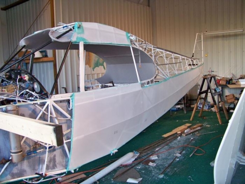

Brief Description:  Covering Side Panels
Started covering the side panels, beginning with the left side. This will go from bottom longeron to the upper longeron. Cut the fabric to size and glued the edges to the frame. I made the final pinking of the edges, final glued them all, then did the fabric shrinks.
nitial fabric shrinking of the left side fabric
