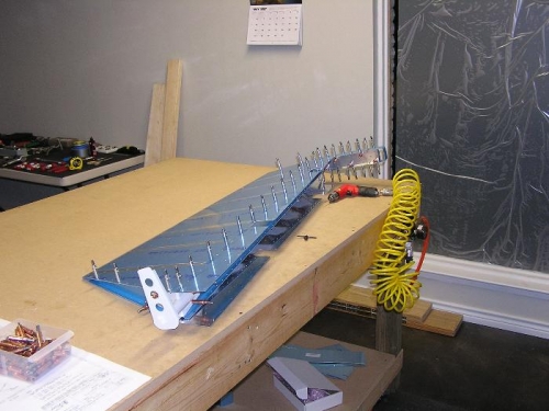

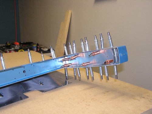

Assembled and final drilled right elevator skeleton and skin. Cut the counterweight to final size and drilled it for attachment to E-703 and E-704. Final drilled the elevator horn to E-702 and E-709.
Right Elevator Clecoed Together
Counter Weight Assembly
