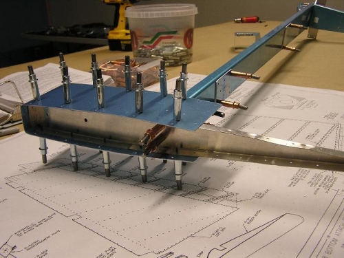

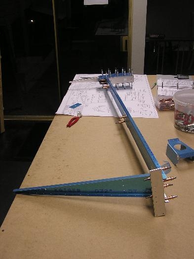

Built the rudder skeleton. Fabricated the R-917 shim per the plans and it fit perfectly. I did have to file down R-405 to get it to fit nicely into R-904.
Start of frame build
Top of rudder where counterweight will go
Bottom of rudder - Close-up of shim placement
