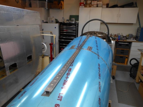

Drilled the location holes in the aft top skin for the canopy slide rail #27 drill for #6 screws.
Drilled #40 holes to mount plate nuts.

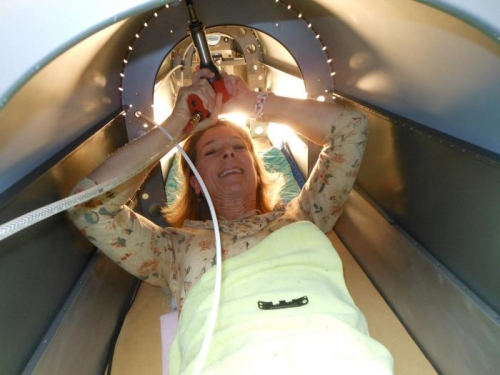

With the help of my wife Terri, plate nuts were riveted in place so the canopy slide rail can be easily removed.
Terri rivetd the seat belt attach points to the aft top skin while I held the bucking bar.
Final installed the canopy slide rail with #6 screws.
Terri riveting plate nuts for the canopy slide rail.
Canopy slide rail mounted.
