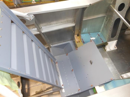

Front seat Ramp

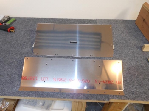

Seat ramps and ribs.
Assembled the seat ramps and ribs.
Drilled all the #40 holes for nut plate attach rivets in seat ramps and support ribs.
Deburred all holes and smoothed all edges.
Dimpled seat ramp and ribs for nut plate rivets.
Scuffed all parts and primed with self etching primer.
Front seat ramps.
Nut plates installed on seat ramp and ribs.
Front seat ramp clecoed in place.
