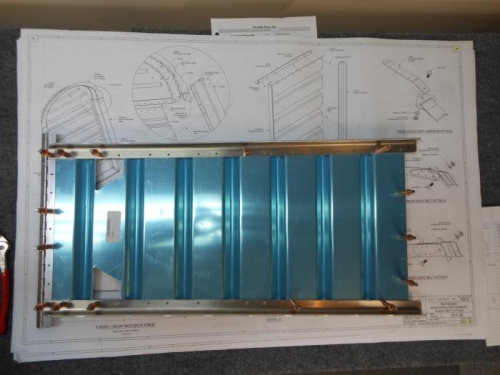

Brief Description:  Front seatback and hinge assembly.
Prepared all front seat back parts for assembly, deburred and smoothed all parts with the scotchbright wheel. Removed the metal tabs from the seatbelt openings, Trimmed the bottom corners of the seatback support angles per the plans. Front seatback hinge cut to length and locating holes drilled. Assembled the hinge all front seatback parts with clecos and drilled all holes.
Front seatback and hinge assembled.
