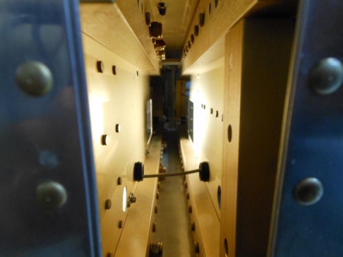

Today I got around to complying with Service Bulletin 16-12-16. The subject matter of the bulletin concerns RV-8QB Missing Center Section Bolts, and the required action to inspect for installation of these center section bolts. It was rather appearant to me that these 12 bolts were not installed in my fuselage. I located the correct bolts and washers and nuts in my hardware and set out to complete the installation. With the help of my wonderful wife with much smaller hands than mine, we were able to install the bolts and torque them properly in about 4 hours of work. Service Bulletin complete.

Fuselage center section channel.  Nuts in place.
