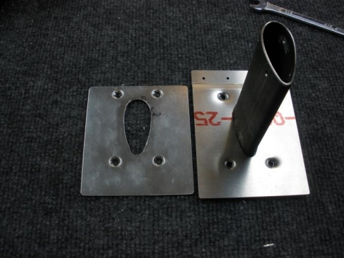

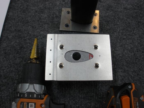

Clecod the .020 spacer to the backing plate and drilled a hole in the mast location large enough to get a step drill bit in to open the hole so my nibler would fit to trim to the dimensions of the pitot mast. Cleaned up the hole with a dremel and a small rotory disk, then touched up with a file.
Cuttting hole in spacer.
Spacer ready for mounting.
