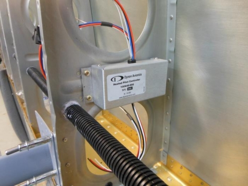

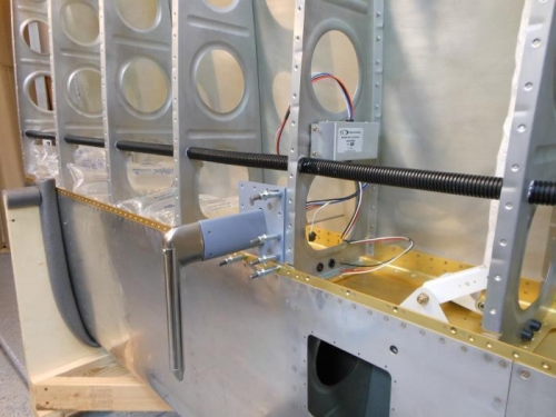

Brief Description:  Mounting the Dynon Heated Pitot Controller.
Mounted the Dynon Avionics heated pitot controller. I opted to mount it in the same bay as the bellcrank due to easier access in case of any problems. Used plate nuts and #6 screws, and a little 1/8 inch weather strip as a backing spacer. Pitot tube mounting is essentially complete minus the plumbing to the pitot tube. I just ordered a tubing bender and tubing flare tool. Once they arrive I can make the connections for AOA (angle of attack) and Pitot System.
Pitot tube heat controller installed.

Pitot tube mounting complete.
