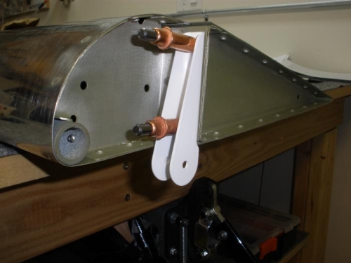

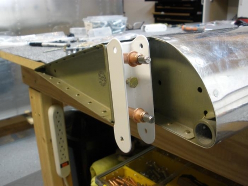

Prepared the Aileron Attachment Brackets for mounting. Clecoed the A-406-1 and the A-407 Aileron Brackets to the left and right ailerons. Drilled to size #12 for attach bolts. Labeled, deburred and primed as necessary, then attached and torqued the AN Bolts.
Outboard Aileron Attach Bracket clecoed for drilling.
Inboard Aileron Attach Bracket.
