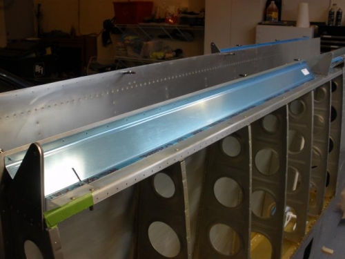

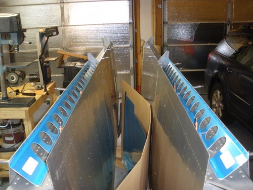

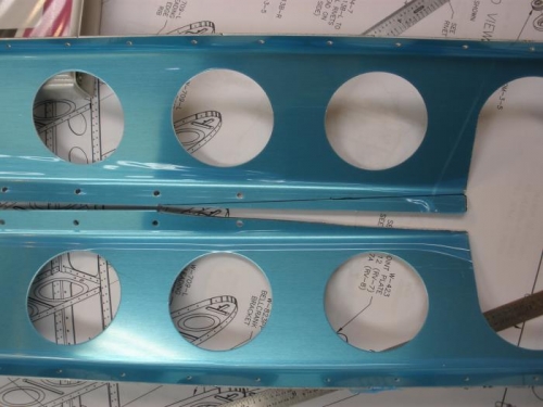

Trimmed the root ends of the Flap Brace per the plans based on the markings on the parts. I should have looked closer before I cut because this leaves you without enough edge distance for the last rivet hole as you can see in picture 1. I clecoed the parts into place on the wing and found that I didnt have to trim that close. Well I thought about it over night and decided I would just order a new part and measure and cut so I would have the correct edge distance and make it right. So beware if you follow the marks on the part you will not have the correct edge distance. I test fit the Aileron Gap Fairing on the wing. Then smoothed the edges on the scotchbrite wheel in preparation for drilling and riveting later.
Flap Brace trimmed at the root end.
Test fitting the Flap Brace.
Test fitting the Aileron Gap Fairings.
