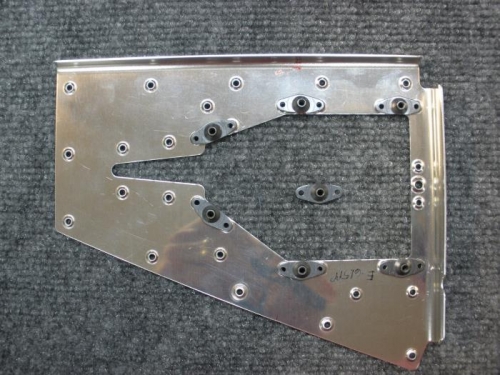

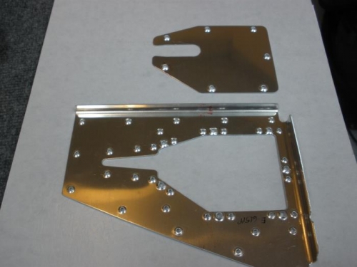

Preparing the elevator skins
Dimpled the E-615 trim reinforcement plate to accept flush rivets.
Dimpled the E-616 trim cover plate to accept flush AN507-6R6 screws.
Trimmed the K1100-06 platenuts so the dont overlap the trim plate and interfere with the trim motor mounts later.
Edge finished the elevator skins with 800 grit paper on a sanding block.
Trim plates dimpled.
Platenuts trimmed on one side.
