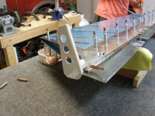

Cleco the E-709 Root Rib to the right Elevator Spar and match drill to #40.
Cleco the E-701 right Elevator Skin to the understructure.
Cleco and match drill the WD-605-1-R elevator control horn to the spar and root rib.

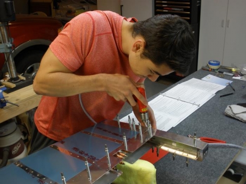

Match drill the E-701 skin to the understructure.

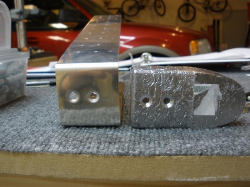

Disassembled the elevator, dimpled the E-713 counterbalance skin and countersink the counterbalance weight for the #8 screw head that will attach the C/B weight.
Machine countersink the E-709 attach holes on the forward face of the E-702 spar.
Beveled the inboard and aft ends of the C/B skin.
Right elevator skin cleco'd in position, control horn match drilled to elevator.
Match drilling the skin
Counterbalance weight countersink for attach bolts.
