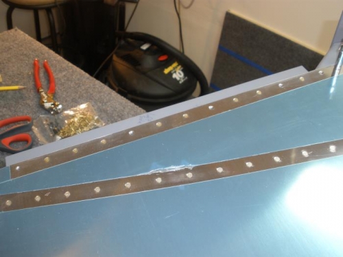

Skin riveted with rudder bottom attach strips.

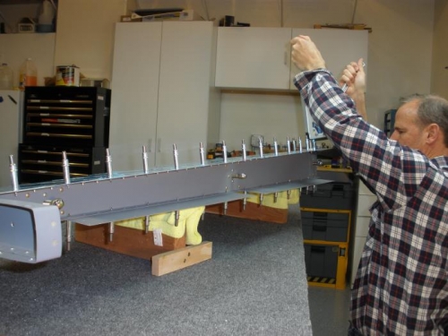

Riveting along the rudder leading edge spar.
