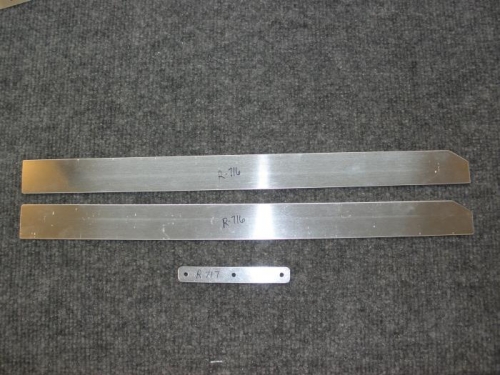

Brief Description:  Assembling parts of the rudder.
Skipped ahead in the instructions to try to assemble some of the rudder parts. Cleco'd three reinforcement plates R-606pp, R-607 and R-608 to the rudder spar. Fabricated three parts from .032 stock per the plans, R-717, and two R-716 rudder bottom attach strips. Match drilled R-717 to the bottom of part R-405pd. All pieces edge finished on the scotchbrite wheel.
Fabricated Parts per the plans.
