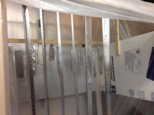

Brief Description:  Wash and primed all VS and HS parts.
Had to build a poor man's paint booth for inside the garage to spary primer on all the VS and HS components. It was way to cold to try spraying outside. All the parts were first washed thoroughly in the sink with Dawn Dishwashing Soap and dried. Then they were carefully hung in the paint booth and sprayed with Valspar A-702 Zinc Phosphate Primer which goes on with a greenish yellow tint. It goes on very thin and blotchy so I elected to add a light second coat to even it out.

All parts hanging and fitted into the small paint booth.
