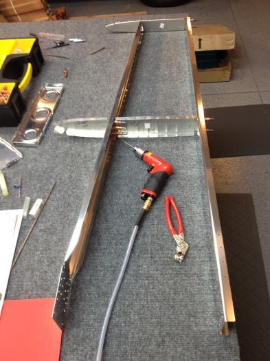

Brief Description:  Starting construction of the right horizontal stab
Got an early start working on the right side of the horizontal stabilizer. It went much faster during the assembly process because the parts for the right side were already prepared. Most of the day was spent match drilling the ribs to the spars and then match drilling the right side skin to the ribs and spars. Once the right side was all match drilled, it was dissasembled and we were able to start the tedious and time consuming task of deburring all the holes we have drilled. The right forward spar was started first before we called it a day.
Clecoing the right side ribs and spars together.

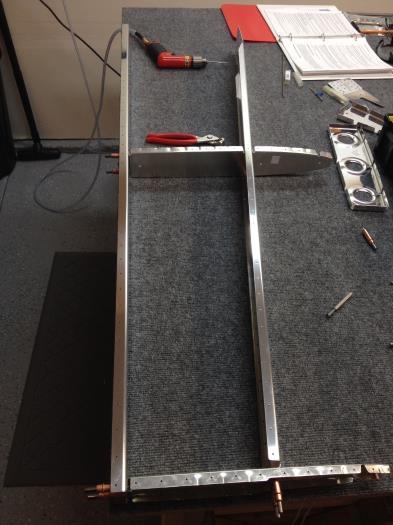

Drilling middle rib to spar attach holes

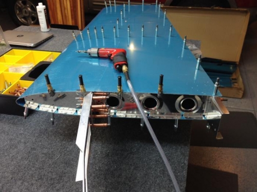

Sk;in in place, match drill inner rib to spar locations.
