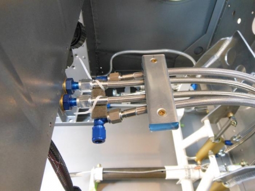

Brief Description:  Installed the Brake Reservoir to Master cylinder L
I installed my brake reservoir lines that I purchased from Tom Swearengen at TS Flightlines. I didnt want to use the plastic lines and fittings that come with the kit and deal with the potential problem of fluid leaks that many others have experienced. Tom I great to work with and I highly recommend his company. I am deviating from the plans some and installing my brake reservoir in the forward baggage compartment as others have done. The outer lines you see in picture #1 are the reservoir to master cylinder lines. You cant see from the pictures but the join together with a 90 degree elbow fitting, a union fitting and a T-fitting. These are zip tied to middle two brake lines. I also constructed a clamp or sandwich out of foam rubber and two pieces of sheet aluminium stock. I coppied this technique from the B-737 that I fly. The foam rubber was drilled for the brake lines and then split thru the middle thru the brake line holes. Then aluminum bent to hold the rubber block, drilled for #8 screws and dimpled. It turned out very secure.

Clamp structure to hold brake lines secure.
