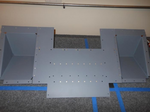

Scuffed and primed the baggage compartment floor.
Dimpled the eight nut plates that attach to the aft flange of the baggage floor and riveted in place.
Back riveted the two forward floor stiffeners in place.
Riveted the left and right footwell assemblies together and then riveted them to the front seat floor.
Back riveting the footwell assembly.
