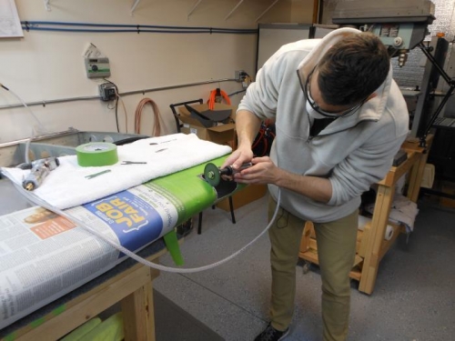

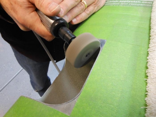

Once the rough hole was cut, we trimmed the hole closer to the lines with a cuttng wheel on a die grinder. To fine tune and smooth the edges, a scotchbrite wheel worked very well.
Rough cut.
Trimming with a cutting wheel on a die grinder.
Final trimming with scotchbrite wheel.
