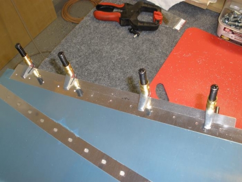

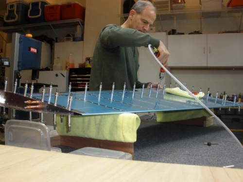

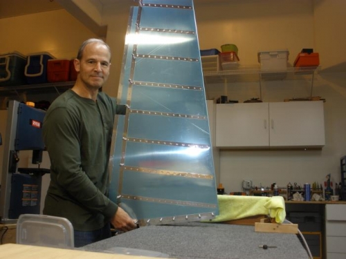

Clamped the R-716 rudder bottom attach strips to the rudder assembly and match drilled using the rudder skin and the lower rudder rib as a guide. Also match drilled the upper rudder rib assembly to the skin as well as the spar web. Rudder assembly now completed and match drilled.
Rudder bottom attach strips clamped.
Match drilling rudder skin.
Rudder assembly comlete.
