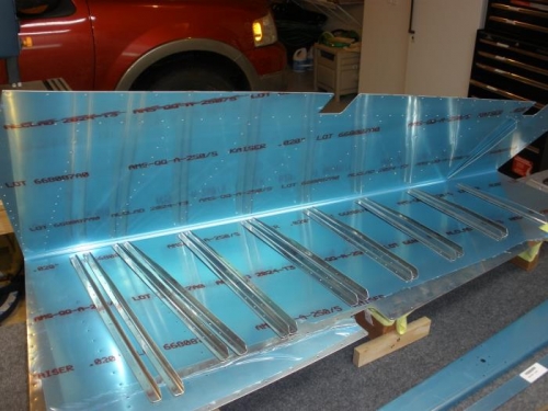

Started work on the rudder. Layed out all the components that will make up the rudder structure. Cut the rudder stiffeners to length on a bandsaw and tappered them to the correct shape. All stiffeners were then edge finished on the scotchbrite wheel.
All rudder components layed out.
