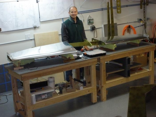

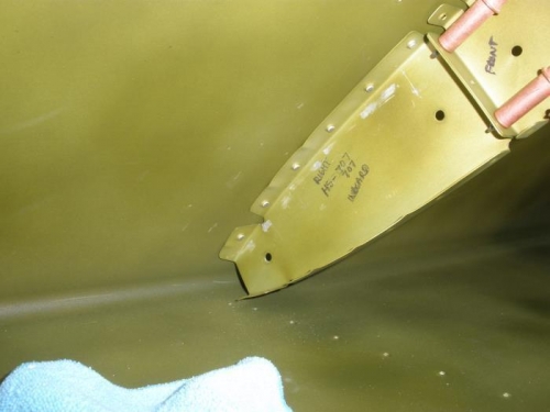

After riveting the left HS skin to the forward spar and aft middle rib, it was time to start assembling the right HS. The two right inboard ribs, HS-00005 & HS-00006 are riveted into place on the forward spar. Had some trouble setting one of the three rivets holding these ribs to the spar because it was very difficult to get a straight shot with the hand squeezer. In the first image the right forward middle rib is being riveted to the skin. The right HS skin is then slid into place over the spar and inboard ribs as seen being done in the second image. Once the skin is in place, its held in position with clecos for final riveting similar to the left side (image 3)
Right side HS forward middle rib riveted.
Sliding the right HS skin over the spar.
Right HS skin ready for riveting.
