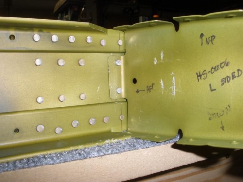

Brief Description:  Attaching left inboard ribs to the forward spar.

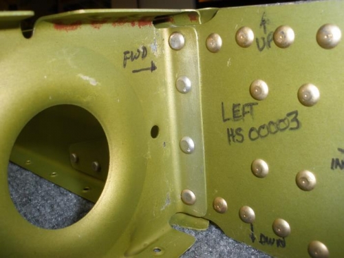

As seen in the first image, the left side forward inboard rib HS-0006 has been riveted into place through the forwar spar assembly and through the aft inboard rib HS-0005 which you can see in image #2. I couldn't reach the rivets with a pneumatic squeezer so these had to be done with the hand squeezer.
Left forward inboard rib riveted to forward spar.
Left rear inboard rib riveted to forward spar.
Forward and aft rib sections on the spar.
