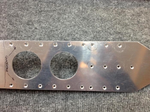

Brief Description:  Deburring, edge finishing, dimpling the VS parts.
Deburred all holes in the VS forward and rear spars as well as all the ribs and the skin. Smoothed edges with the scotchbrite wheel. Drill countersinked the 22 holes in lthe lower portion of the rear spar reinforcement per the plans. Dimpled all holes in the VS skin and understructure.
VS rear spar reinforcement--22 holes countersunk.
