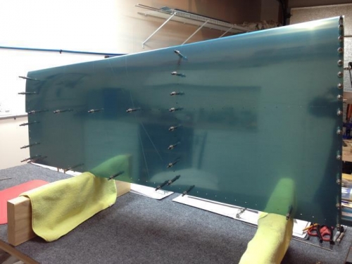

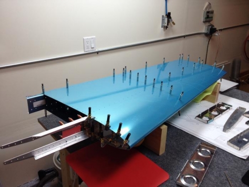

Reinstall the inboard ribs HS00005 and HS00006, cleco'd into place and match drilled all the holes that will be used to attach them to the FWD and Rear spar assembly. Match drilled all the holes in the left HS skin to the ribs and spar framework.
Fwd inboard rib clamped into position for drilling
Match drilling all the holes in the left HS skin..

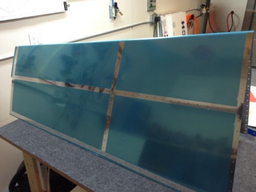

Skin removed, ready for dimpling
