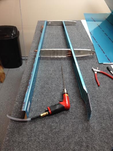

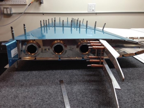

Cleco'd the left side of the HS rear spar and the fwd spar channel to the middle ribs and the outboard rib. Drilled to enlarge the rib to spar attach holes with a #30 drill bit. Holes deburred, and parts recleco'd. Cleco'd left HS skin HS-801PP onto the framework. Cleco'd the HS-00003 spar doublers, HS-810-1 and HS-814-1 reinforcement angles to the forward spar as seen in photo 3. The inboard ribs have also been slipped into place and the approximate rivet hole locations marked on the top and bottom of the inboard rib flanges. Fluted the inboard ribs between the marked hole locations.
Spars and ribs cleco'd together
Left HS skin cleco'd onto the framework
