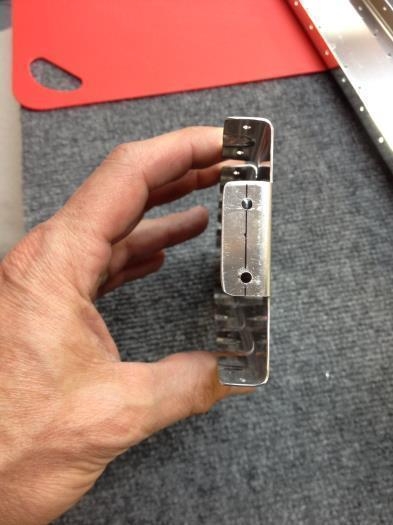

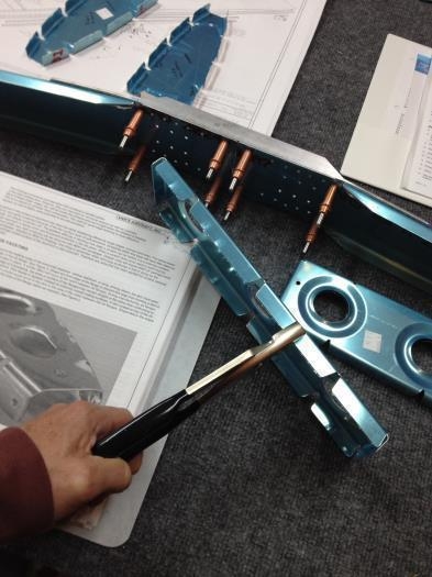

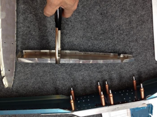

Made a notch in the aft end of the HS-00006 fwd inboard rib to fit around the fwd spar reinforcement angle. Marked the centerline on the aft flange of the fwd inboard rib. Located the holes for attachment to the fwd spar. Fluted all the ribs to straighten the bow in them except for the inboard ribs which will be straighten/fluted after the rivet holes are marked on their flanges.
Rib notched, C/L marked and holes drilled.
Fluting ribs
Fluting ribs
