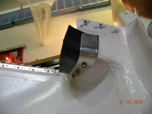

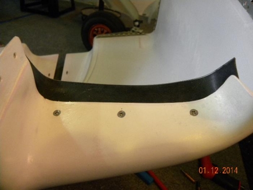

Brief Description:  Front Baffle Seals
Checked off one of the many mundane tasks left to wrap this baby up. For the front baffle seal you actually need to form an aluminum backer plate / clamp that holds the rubber seal in place. The cowling fits surprisingly well even with these baffles in place. The cowl and baffles has been a pretty tall order and the fit and finish is coming out pretty good.
