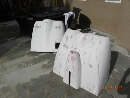

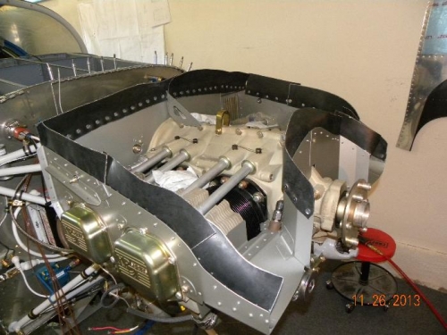

Brief Description:  Cowl & Baffles
I rolled on 3 coats of filler primer (poly fiber) on the cowl halves yesterday. I used up about a quart in total. I let it cure overnight and today i sanded most of it off. Heavy duty stuff, this took about 4 hours to sand down with an orbital sander. The next step is to prime over it with a two part epoxy primer after letting it cure for seven days. I previously treated my wingtips in the same process so they will get the primer too.

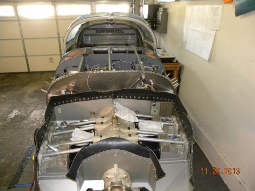

I finished off the cowl baffles by riveting on the rubber baffle seal material to the tops of the aluminum baffle. Each piece was measured, cut, drilled and riveted in place
Filled & Sanded cowl halves
Cowl baffle seals
Cowl baffle seals
