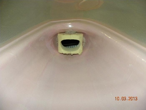

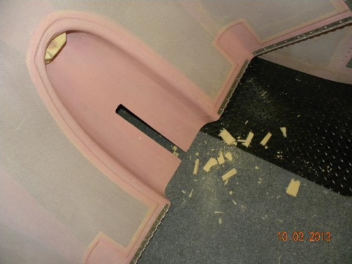

The interior of the lower intake air snorkel needs to be extended into the cowl to mate up with the intake on the filtered airbox.
The basic procedure is to create a mold to do a fiberglass layup against. I used a block of foam and rammed it inside the snout and glued it in place. After installing the cowl I used a hack saw blade to cut out the inside, feeling my way around the inner wall of the FAB.
Foam block stuck into snout
cut out inside shape
