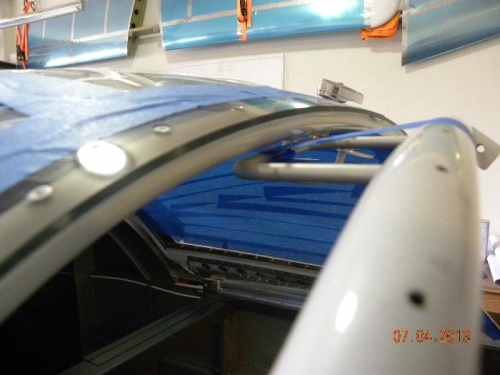

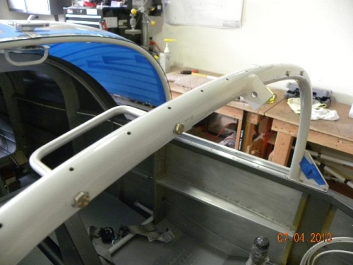

Installed a pair of aluminum handles across the windscreen roll bar. These are the same as the canopy handle I installed on the rear of my sliding canopy. I carefully positioned them so they would skin slightly below the slider bow and not interfere. The tricky part is drilling the holes square and perpindicular through the roll bar. These penetrate one side of the bar and fasten against the inside of the opposite side of the tube. They are fairly strong and should be a good assistance climbing in and out.

The Handles pass slightly below the slider
AN3-4a bolts fasten through roll bar and into threaded aluminum
