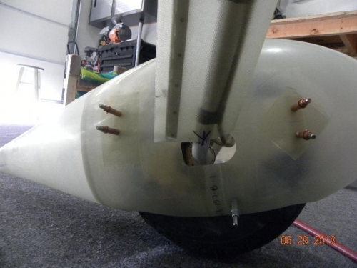

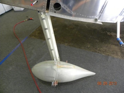

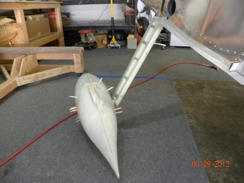

Brief Description:  Wheel Pants Fitted
I dont have the plate nuts installed yet but the fairings are all drilled, reinforced and mounted in postion. I have to decide if im going to fasten these with tinnerman washers, or just the screws themselves , as that will determine the countersink size. I removed them one last time to enlarge the wheel cutout to ensure clearance around the tire (5/8" recomended all-around).
Clecos to inner bracket and reinforcing
