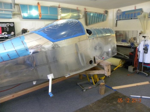

Brief Description:  Install landing Gear

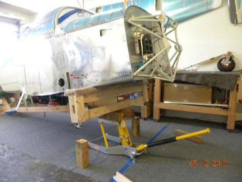

Installed the landing gear legs. You must raise the fuselage very high (about another foot higher than captured in any photo below) This was tough to do by myself, need one person to hold the gear leg while the other installs the bolt next time. I had to fenagle some rope contracptions to hold the leg in place.
I am astonished at how high this thing stands on the gear. I suppose it wall squat a little more when the wings and engine are on but right now i stand eye to eye with the top of the forward skin.
Without the engine, it is tail heavy and needs to be supported in the rear
