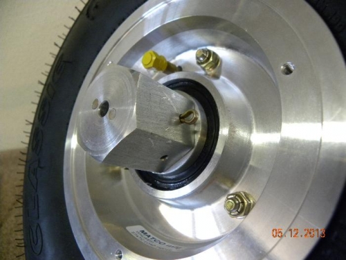

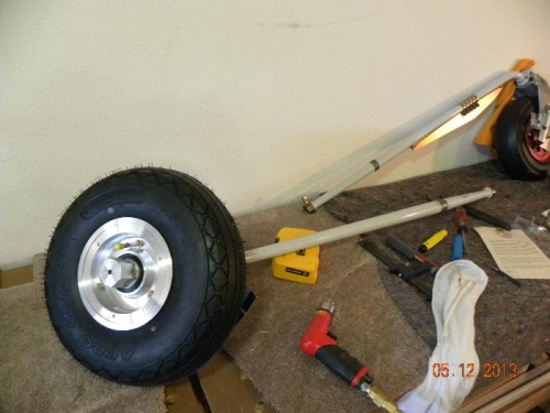

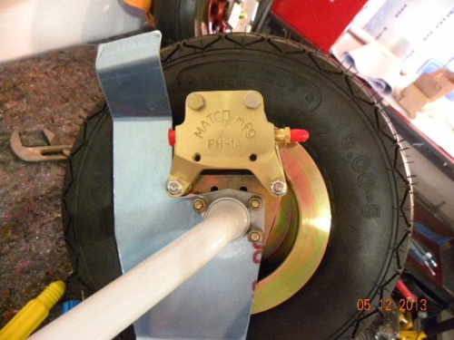

Brief Description:  Main gear wheels & Brakes
Installed the main wheels and matco brake assemblies on the main gear legs. First i packed the wheel bearings with some aeroshell 5. The wheel nut here is supposed to tighten in order to hold the wheel bearings from spinning with the wheel, but you dont want too much friction, or i guess the gear legs would wobble like heck. This is a bit of a crap shoot here, i also imagine things get settled in a bit after the first few landings. Drilling the hole for the cotter pin throught the threaded body of the main gear was difficult.
